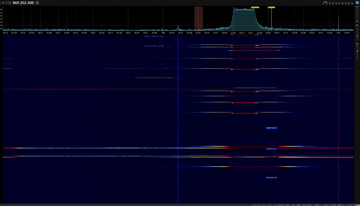

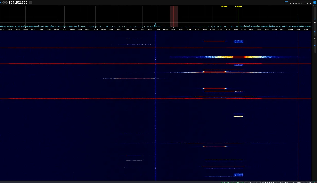

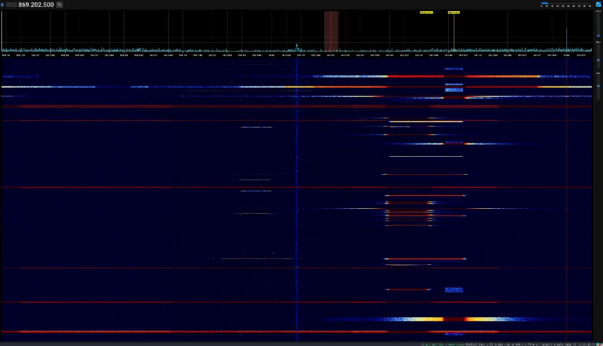

            Meshtastic Citymode (125kHz, links) vs. Meshtastic MediumFast (250kHz) vs. Meshcore UK/Narrow (62.5kHz, rechts)
